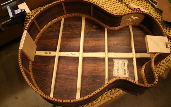

What do you guys think?
Camatillo Rosewood with a Sinkerwood/Englemann double top. Its a commission and should be ready in a few weeks...

Looks superb so far Peter, how thick did the double top finish out and what kind of appointments do you and your client have in mind?
Make sure you post some more images as you go.

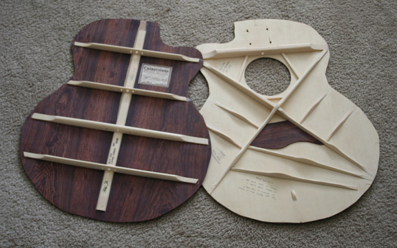

Lance, I took a different approach to this double top construction. I used the same priciple as normally done with nomex but only used 2 tops and skipped the nomex!
I mapped the bottom top with all the bracing positioning and bridge patch, etc... and drilled the other areas honeycomb style creating a hollow area on the selected areas. In essence I have a same thickness double top but lighter and partly hollow...
Its tap tone is pretty "boomy" so I'm excited to see (hear) and it'll turn out!

Looks great Peter. Did you have any trouble bending the camatillo?
Do you have any pics of the drilled out areas of the top before joining
them together?

Well, first off the laminated tops are made of cheap laminated ply woods that are offen cross grained layers topped with a wood veneer... whatever they decide, mostly spruce.
A double top is a bit different. 2 or even 3 real tonewood tops are used and then one of them is hollowed out and the empty area is filled with Nomex (a honeycomb very ligth and strong material) so the tops retain their strength but become lighter and more flexible.
In my particular case I only drilled the area in a honeycomb style creating a hollow area on selected areas. The top was left at about .115 as a regular top.
I only hollowed out the lower bout area in an attempt to try to affect the vibrating areas.
PostPosted: Tue Oct 17, 2006 1:42 pm
Thanks Mike, the Camatillo was a dream to bend. Better that EIR. but a lot heavier. I like it!
I do have some pics....will post later.
